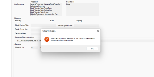

I am getting, below Error while reading a DLMS Meter.
GXDLMS Director Error: Specified argument was out of the range of valid values. Parameter name: MaxInfoRX
I have same type of another Meter (Manufacturing Year can be different, but same firmware version) , which works fine with Director Software.
So, Please help me to identify issue.

Hi, The HDLC frame size must…
The HDLC frame size must be between 32 to 2030 bytes. The meter tries to use values that are not within the DLMS standard values.
I believe you need to change the proposed HDLC frame size. Select the "Frame" tab and change the Max payload size from 128 e.g. 256.
