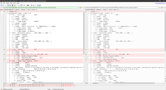

Attaching compare of HDLC…
Attaching compare of HDLC packets. Left: DLMS Director, Right - our application. Packets are same with the exception of send and receive packets numbers a CRC which is normal.
2 years 11 months ago
