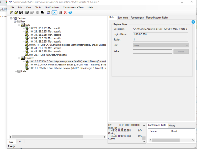

HI. I have tried to take the values for the 1.0.9.6.0.255 and 1.0.10.6.0.255 under register. This communication in done using high authentication. But cannot obtain the result. While other required parameters such as energy can obtain.

Check what are the access rights. It might be that you don't have enough access rights to read those values.

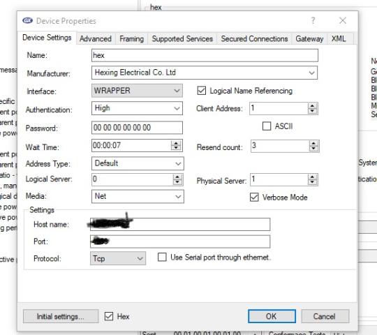

Thanks for the reply. Maximum demand was in the extended register, and it reads. But when i try to add 1.0.4.8.1.1 to register it allow to add without any errors but readings are not coming. this are my settings.
