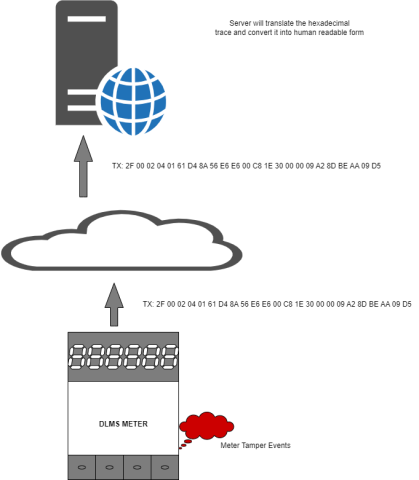

I want to understand more…
I want to understand more about this push listener. Below I am given a block diagram related with if a tamper event occurs in a meter. And it is sending the packets to server which is listening the meter.
If meter sends the packet push listener example will translate to human readable form?
