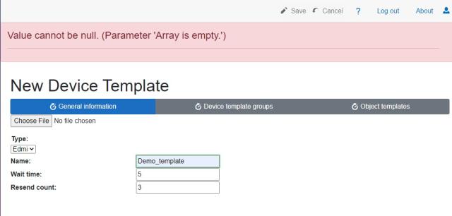

Good day, I pulled the…
Good day,
I pulled the latest image today, 4/4/2023, and run it.
I still can't see the Add Device form and when I try to add a device template, I get an error "Value cannot be null. (Parameter 'Array is empty.')"
3 years 3 months ago
In reply to Good day, I pulled the… by tukur
Hi, Do you have any data in…
Do you have any data in your template? Can you share it so we can test with that? I just test this with clean database and the latest docker and it worked without problems.

The only data I'm using is…
Wait time: 5
Resend count: 3
Just want to see it work, then I will create a device, but even the Add Device is empty as I told you.
I'm using windows 11
In reply to The only data I'm using is… by tukur
Hi, Now I know what you have…
Now I know what you have done. You have created a device template, but not selected the file that contains meter information.
Remove your device template. Then connect for your meter with GXDLMSDirector and save it. Then select that file and import it so device settings are updated.
DLMS meters are very different and without that information it's not possible to connect for the meter.
I created an issue that device template can't be added if device settings file is not selected.
https://www.gurux.fi/issue/guruxdlmsami4/20713

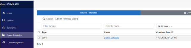

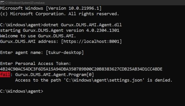

It has worked now, but when…
It has worked now, but when I came to running the agent. It said "fail: Gurux.DLMS.AMI.Agent.Program[0]
Access to the path 'C:\Windows\agent\settings.json' is denied."
Hi, Is settings.json file…
Is settings.json file exists? Try to remove it and try again.
