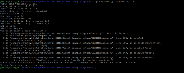

i was follow the tutorials from https://www.youtube.com/watch?v=OcmYvcsgjz4&t=7s.
when i try in my meters using raspberry 3b+, i have error like this :
gurux_dlms version: 1.0.141
gurux_net version: 1.0.19
gurux_serial version: 1.0.20
ClientAddress: 0x10
Standard: Standard.DLMS
3 years 4 months ago
Hi, Settings vary between…
Settings vary between the meter. Change server address to 145 (0x91).

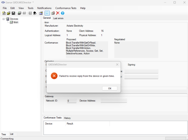

krisna123
In reply to Hi, Settings vary between… by Kurumi
I was download…
I was download GXDLMSDirector, but i can't find Itron SL7000 761. What should i do ?
In reply to I was download… by krisna123
Hi, Itron bought Actaris and…
Itron bought Actaris and SL7000 is Actaris model. Select Actaris as a manufacturer.
krisna123
In reply to Hi, Itron bought Actaris and… by Kurumi
I still getting error like…
I still getting error like this :(
In reply to I still getting error like… by krisna123

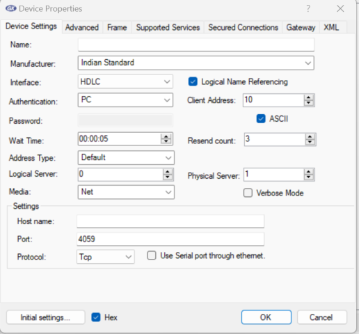

Hi, You need to change meter…
You need to change meter address. Try to set physical address to 11 and logical to 1.
Check SL700 settings from here:
https://www.gurux.fi/GXDLMSDirectorExample
