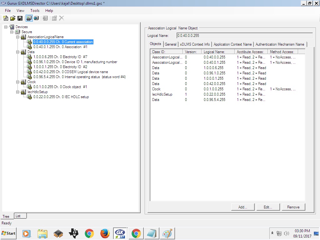

Hello Sir,
I want to read Secure i-credit 350 meter. I am trying since 15 days and i established connection but, i am not able to read voltage and current.
As i am using DLMS Protocol, i found in one post and you suggest there to refresh device after connection, it will automatically read supported OBIS Code from meter. but, in my case it is not working.
i attachedDLMS connection JPEG file. Kindly Reply me.
i used only one OBIS Code and that is Data-0.0.42.0.0.255
Manufacture settings:
Flag ID:EHL
Using logical name referencing: checked
keepinterval: 40
start protocol: DLMS
Addressing:
authenticatoin:none
client address
address(hex):10
server address
address type:Default
serial number formula
physical:1
logical:0
Device properties:
manufacture:Secure meter
Logical name referencing:checked
start protocol:DLMS
media:serial
authentical:none
password:
waittime:7
client address: 10
address type:default
physical address:1
logical address:0
settings
serial port:COM11
My log file is also here.
GXDLMSDirector 8.0.1708.1801

Secure i-credit 350 shows data but not register
Usually problem is that you must use Low authentication to get all data.
With some meters connection without authentication will show only small part of the data.
You need password if you want to use Low or High Authentication. You must ask this from meter vendor if that is not on the manual. We don't know it.
