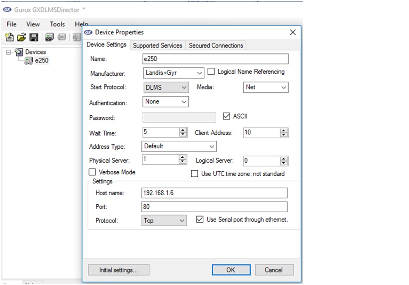

I m trying to connect to my Landis+Gyr E250 DLMS meter with DLMS director with following settings but getting error
GXDLMSDirector 8.0.1706.1107
Log created 12:44:57 AM
12:45:04 AM Initializing Network connection.
12:45:04 AM Send SNRM request.
7E A0 07 03 21 93 0F 01 7E
12:45:09 AM Failed to receive reply from the device in given time.
System.Exception: Failed to receive reply from the device in given time.
at GXDLMSDirector.MainForm.Connect(Control sender, Object[] parameters)
Protocol: DLMS
Manufacturer: Landis+Gyr
Authentication: none
Address type: default
Wait time : 5
client address : 10
physical server: 1
Resend Count: 0
Host name - Laptop ip address
Port - 80
proctocol- TCP
Could you please help with this. I have also tried the default setting but it didn't work.
