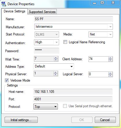

I am trying to connect a ISKRA MT880 via network.
The meter is connected to the net via media converter ethernet -> RS485 and it is accessible via ISKRA software without any problem.
In director I have setup the ip address, password, and the hdml address of the counter. When I try to connect no answer.
I have attached a snapshot of the settings.
Any idea what's could be wrong.
Thanks a lot

Try to change settings described http://www.gurux.fi/GXDLMSDirectorExample
If that is not working you can send your MeterView trace to me by email and I'll tell what parameters you should use.

Trace
not sure if you need this ... otherwise please let me know.
Thanks a lot
Best regs
gp
HDLCAddress 74
ProtocolDriver MeterHDLC
PurgeBeforeSend False
SendDelay 0
CommunicationParameters 0
DeviceDriver DlmsDriver
InstanceMapPath IskraemecoIcg
ProtocolParameters 0
ConnectionDriver Network
ConnectUsing Network
ServerIP 192.168.1.105
ServerPort 4001
TimeOut 5000
ActivateBeforeUpgrade True
ClientAddress 1
IEC1107Mode False
InvokeIdAndPriority 64
Password LETTER
ProtocolDriver MeterCOSEMIcg
ReadWithList False
ReadWithListCount 1
ServerAddress 1
SubdriverProtocol 1
UseUnconfirmedServices True

There is view Log or something like that on the menu. You can see sent and received bytes.
That is what interest me.
I just realized that I do not know is your TCP/IP to serial port converter supporting baud rate changing.
Select "Use serial port through ethernet". That might help.
