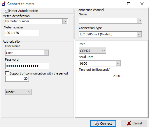

I attach the logs of the native program and Gurux:
230213 11:07:48:256 Information: "Port is opened"
230213 11:07:48:263 Mode E
230213 11:07:48:272 --> 2F|3F|21|0D|0A|
230213 11:07:49:623 <-- 2F|4E|49|4B|35|5C|32|4E|49|4B|32|33|30|37|20|76|32|2E|30|30|2E|0D|0A|
/NIK5\2NIK2307 v2.00.
230213 11:07:49:636 --> 06|32|35|32|0D|0A|
230213 11:07:50:191 <-- 06|32|35|32|0D|
230213 11:07:50:193 End Mode E
230213 11:07:50:196 COMMAND_SNRM:
230213 11:07:50:200 --> 7E|A0|0A|00|00|00|01|21|93|13|D1|7E|
230213 11:07:50:254 Receive 7E|A0|21|21|08|C6|08|51|73|EE|E4|81|80|12|05|01|80|06|01|80|07|04|00|00|00|01|08|04|00|00|00|01|53|3B|7E|
230213 11:07:50:270 261
230213 11:07:50:275 COMMAND_AARQ:
230213 11:07:50:276 --> 7E|A0|50|00|00|00|01|21|10|18|FC|E6|E6|00|60|3F|A1|09|06|07|60|85|74|05|08|01|01|8A|02|07|80|8B|07|60|85|74|05|08|02|01|AC|12|80|11|00|31|31|31|31|31|31|31|31|31|31|31|31|31|31|31|31|BE|10|04|0E|01|00|00|00|06|5F|1F|04|00|00|08|CB|00|80|9C|46|7E|
230213 11:07:50:472 Receive 7E|A0|3B|21|08|C6|08|51|30|EF|C8|E6|E7|00|61|29|A1|09|06|07|60|85|74|05|08|01|01|A2|03|02|01|00|A3|05|A1|03|02|01|00|BE|10|04|0E|08|00|06|5F|1F|04|00|08|80|00|04|B0|00|07|C4|42|19|7E|
230213 11:07:50:488 61
230213 11:07:50:491 00
230213 11:07:50:494 Get meter info
230213 11:07:50:498 --> 7E|A0|1C|00|00|00|01|21|10|84|8A|E6|E6|00|C0|01|81|00|01|00|00|60|01|0A|00|02|00|D1|77|7E|
230213 11:07:50:591 Receive 7E|A0|25|21|08|C6|08|51|30|07|FB|E6|E7|00|C4|01|81|00|0A|10|45|4D|37|31|35|41|5F|76|32|2E|30|30|2E|37|34|39|CC|7F|7E|
230213 11:07:50:604 --> 7E|A0|1C|00|00|00|01|21|10|84|8A|E6|E6|00|C0|01|81|00|01|00|00|60|01|0C|00|02|00|4B|3C|7E|
230213 11:07:50:687 Receive 7E|A0|18|21|08|C6|08|51|30|02|03|E6|E7|00|C4|01|81|00|06|10|02|00|00|62|A9|7E|
230213 11:07:50:703 --> 7E|A0|1C|00|00|00|01|21|10|84|8A|E6|E6|00|C0|01|81|00|01|00|00|60|01|01|00|02|00|C4|B7|7E|
230213 11:07:50:788 Receive 7E|A0|35|21|08|C6|08|51|30|CE|4E|E6|E7|00|C4|01|81|00|0A|20|4E|49|4B|20|32|33|30|37|20|41|52|54|20|54|2E|31|32|30|30|2E|4D|2E|32|31|00|00|00|00|00|00|00|00|4A|30|7E|
230213 11:07:50:821 --> 7E|A0|1C|00|00|00|01|21|10|84|8A|E6|E6|00|C0|01|81|00|01|00|00|60|01|00|00|02|00|7F|AB|7E|
230213 11:07:50:904 Receive 7E|A0|1D|21|08|C6|08|51|30|A1|F3|E6|E7|00|C4|01|81|00|09|08|23|07|10|01|11|76|20|18|D2|81|7E|
230213 11:08:36:522 --> 7E|A0|0A|00|00|00|01|21|53|1F|17|7E|
230213 11:08:36:566 Receive 7E|A0|0A|21|08|C6|08|51|1F|85|58|7E|
230213 11:08:36:701 Information: "Port is closed"

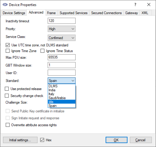

Can you please tell me where…
Can you please tell me where can I change the SNRM request length to 12 bytes?
Gurux send only 9 bytes.
In the native program, the request looks like this
7EA00A00000001219313D17E
BigAlex
3 years 5 months ago
Can you add your own…
Can you add your own standard?
The native program seems to add a few bytes to the requests.
