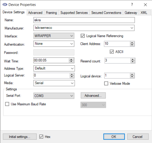

I've tried to create a device on GXDLMSDirector for the Iskraemeco meter with the suggested settings
https://www.gurux.fi//GXDLMSDirectorExample
But the interface can't be changed to IEC (Options are HDLC, HdlcWithModeE and WRAPPER). I've tried to change the settings, but the error "Failed to receive reply from the device in given time" keeps showing up.

You need to change the interface from WRAPPER to HdlcWithModeE. Then connect again.

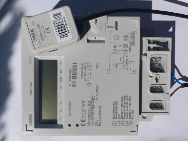

The meter is an ISKRA M19 1376, as seen in the image. We don't have the technical description for it.

The first thing that I can see is that the optical probe must be downward. Now it's not, and it can cause problems with the communication. I also can see that the meter is not powered, but maybe it's only when you did take the picture.
The main issue is that Iskra ME 172 is not supporting DLMS. It's using IEC 62056-21 also known as IEC 1107. The good thing is that it should reply for /?!<CR><LF> and give a readout right the way.

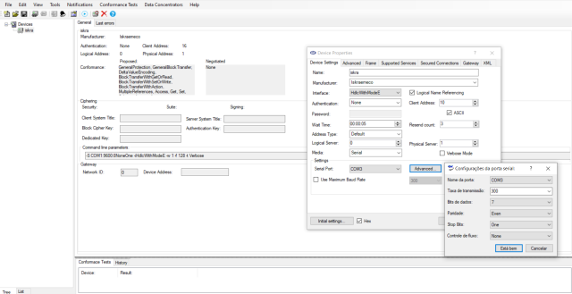

You need to try with different baudrates. Set serial port baudrate to 300 and Data bits: 7, Parity: Even and StopBits: 1. Then try to send /?!\r\n.

I went outside for better light. The meter is running correctly, and we're able to read measurements with another app (ZRobo) with this setup.
I've checked, but those settings were already being used. I've also tried to connect with different baudrates with no success... What else could be done?

You can't read the meter with GXDLMSDirector because it's not supporting DLMS, but the meter should reply for "/?!<CR><LF>". GXDLMSDirector sends this when you establish the connection using Mode E and you should get a reply where the meter identifies itself.
Do you see what serial port settings ZRobo is using?

All I can see in the app is that it's at 300 baud rate.
