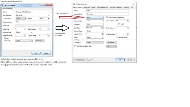

Hi Mikko
Hi Mikko
See attach jpg, the difference between your example and actual software am I using the correct version?

Iam ussing Rs485 and not the
Iam ussing Rs485 and not the optical head.
4 years 7 months ago
HDLC is selected for interface and it's correct. I can't remember the client and server address for the RS-485, but you can find that from the meter manual.

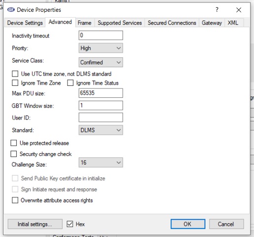

Under the Advance Tab there
Under the Advance Tab there is user ID must it be blank.
Don't set user id. It's not used.

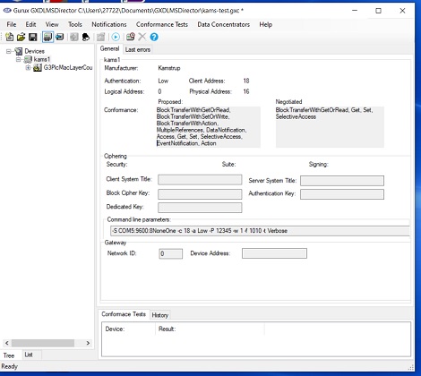

When I connect, I get the
When I connect, I get the following in the Negotiated text box:
BlockTransferWithGetOrRead, Get, Set, SelectiveAccess

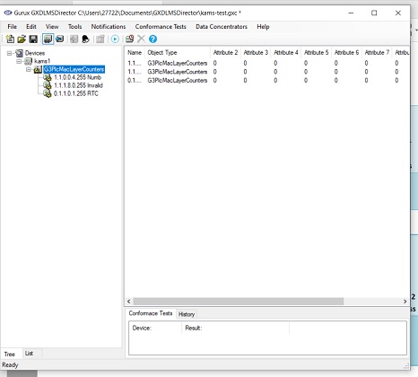

Here is my object stil no
Here is my object stil no data
Gerdus
Thanx got it to work. Deleted the old one and started from scratch.
