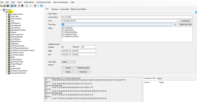

could you please tell me why I can not set the clock time or the timezone?
Meter Type:
Landis & Gyr E450 DLMS Idis
Authentication is LOW level.
Am I doing something wrong?
Thank you and best regards,
Manuel
GXDLMSDirector 8.2.2202.0901
Log created 09:39:42
09:39:45 Disconnect request
7E A0 07 03 03 53 80 D7 7E
09:39:45
09:39:47 Initializing serial connection.
09:39:48 Send SNRM request.
7E A0 07 03 03 93 8C 11 7E
09:39:48
7E A0 1E 03 03 73 40 CC 81 80 12 05 01 80 06 01 CA 07 04 00 00 00 01 08 04 00 00 00 01 30 7E 7E
09:39:48 Parsing UA reply succeeded.
09:39:48 Send AARQ request.
7E A0 44 03 03 10 65 94 E6 E6 00 60 36 A1 09 06 07 60 85 74 05 08 01 02 8A 02 07 80 8B 07 60 85 74 05 08 02 01 AC 0A 80 08 31 32 33 34 35 36 37 38 BE 10 04 0E 01 00 00 00 06 5F 1F 04 00 1C 03 20 FF FF 88 81 7E
09:39:49
7E A8 25 03 03 30 18 6A E6 E7 00 61 29 A1 09 06 07 60 85 74 05 08 01 02 A2 03 02 01 00 A3 05 A1 03 02 01 00 A6 AE 7E
09:39:49 Get next frame.
09:39:49 Send AARQ request.
7E A0 07 03 03 31 94 97 7E
09:39:49
7E A0 1B 03 03 32 9A F1 BE 10 04 0E 08 00 06 5F 1F 04 00 1C 02 20 05 DC FA 00 E2 E8 7E
09:39:49 Parsing AARE reply succeeded.
09:40:03 Writing object 0.0.1.0.0.255, interface Clock
7E A0 15 03 03 52 DE 3C E6 E6 00 06 01 02 02 68 01 10 FF C4 4C 33 7E
09:40:03
7E A0 0F 03 03 54 E7 46 E6 E7 00 0D 01 00 07 E4 7E
09:40:03 Reading object 0.0.1.0.0.255, interface Clock
7E A0 11 03 03 74 06 0A E6 E6 00 05 01 02 02 68 D6 4F 7E
09:40:03
7E A0 12 03 03 76 D9 0C E6 E7 00 0C 01 00 10 FF C4 66 3A 7E
09:40:13 Writing object 0.0.1.0.0.255, interface Clock
7E A0 20 03 03 96 53 9E E6 E6 00 06 01 02 02 60 01 09 0C 07 E6 03 0B FF 09 28 0D FF FF C4 00 F0 57 7E
09:40:13
7E A0 10 03 03 98 DF 3B E6 E7 00 0D 01 01 FA 2E C5 7E
