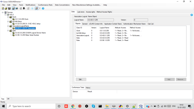

We are using HPL Three Phase meters and tried to read it using the 'Indian standard' option of the Gurux DLMS Director but we were only able to read logical name and serial number. Looks like we are not able to read the other parameters because the password is not there for a low security authentication!
The screenshot of the parameters that we are able to read is attached here
No other parameters we are able to read.
Can someone advice on how to read the same?
We have three phase CT operated meters and a whole current meter that we are trying to read from the DLMS Director.

You need to change authentication from None (PC) to Low (MR) and set the correct password.
