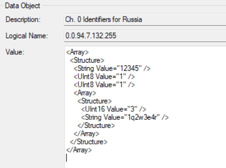

Thats OK. Read data (see attached screenshot).
Now i try string value "12345" change to "99999" and write to server:
11:52:26 Writing object 0.0.94.7.132.255, interface Data
7E A0 39 03 61 98 0A 1B E6 E6 00 C1 01 C1 00 01 00 00 5E 07 84 FF 02 00 01 01 02 04 0A 05 39 39 39 39 39 11 01 11 01 02(<--wrong. must be 01 - Array) 01 02 02 12 00 03 0A 08 31 71 32 77 33 65 34 72 7E BF 7E
and data of this object changed: inner array changed to structure.

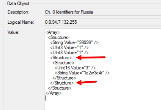

Red arrow after writing data
4 years 8 months ago
Hi Dmitry,
Hi Dmitry,
We have fixed a meter issue for one of our clients and because of that, you can't write the correct value.
That was a long time ago and I'll ask if this is fixed for the meter we can remove this fix.
It's in GXCommon.SetArray method:
if (dt == DataType.Array)
dt = DataType.Structure;
I'll let you know the answer later this week. If it's not fixed for the meter we must think of something else.
