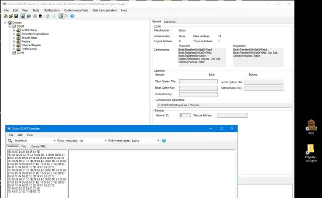

Look into attachment, there is my print screen.
Best regards,
Zdenek
4 years 10 months ago
Ciphering tab is missing. Can you select "Help" and "Library Versions". Can you add your version information here? I'll check this on Monday.
