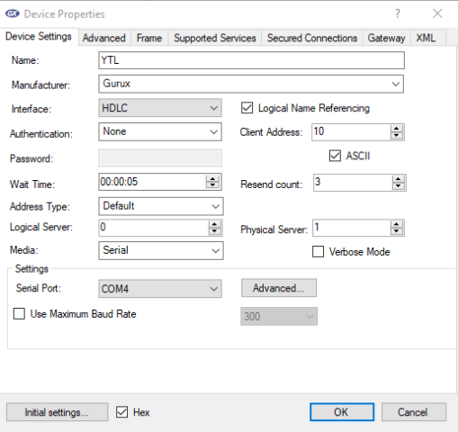

Hello, I am trying to Read by GXDirector a Chinese meter of the YTL Brand Reference DTS-353-CT / V3D, this says that it can be read by using DLMS protocol. It works with communication through RS485 2 Pins (A-B). However, using the GXDirector I have not had a response by using the RS485 Port, and I have tried with an Optical Probe and I have obtained a response using the configuration shown in the shared image.
The configuration for probe communication is the following in my case:
Port: COM4
Baudrate: 9600
DataBits: 8
Parity: None
Stopbits: One
The response obtained is the following accompanied by the error window with the message "Failed to receive reply from the device in given time". Could someone help me to identify how I can proceed to read the Meter and obtain the respective objects. Thank you.

4 years 5 months ago
Change those settings and I believe it will start to work.
Logical address: 1
Physical address: 0x2327
dwnmastrodomenico
Thanks Mikko for your help, I
Thanks Mikko for your help, I was able to bring the meter objects. Could you tell me, how did you determine the values for Logical address: 1 and Physical address: 0x2327?
With the change made in the Logical Address and the Physical Address, the frame sent was the following to the meter
The HDLC server address consists of the Logical and Physical addresses. That is described on the HDLC standard. You can read more from here:
https://www.gurux.fi/dlmsAddress
