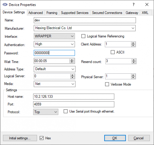

HI Mikko
HI Mikko
Yes the current configuration does use the wrapper setting. I have attached a screenshot with the settings used. I was able to connect to a HXE130 with the same settings.
4 years 11 months ago
Try to check "Logical Name Referencing".
GrantC27
I think I unchecked that by
I think I unchecked that by mistake, but usually it is checked. Are there any settings on the other tabs that would need to be adjusted, for example security? Is there any other log or piece of information I can provide to try understand a bit better what is coming back? I am sure many people have successfully communicated with this device, it just feels like there is something I am missing
It might be that you are not allowed to connect without authentication or ciphering. Is this a new meter?
