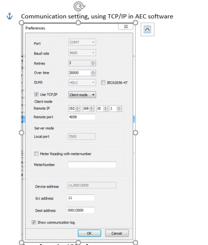

The client's address can be anything. It's not defined on the DLMS standard and different manufacturers are using the different values. You need to check that from the documentation.
If you don't find it you can add hex trace from the AEC meter software communication messages and I'll find the correct settings for you.

Noted, the trace files are not in detail (Hex trace) which comes from AEC software, Below sample trace, will this be useful?
Trace from the AEC software
30-Sep-21 2:32:38 PM Open service, IEC62056-46.
30-Sep-21 2:32:38 PM Remote IP: 192.168.10.1 Remote port: 4059.
30-Sep-21 2:32:39 PM Socket opened.
30-Sep-21 2:32:40 PM MeterNo = 60087274.
30-Sep-21 2:32:40 PM Get: COSEM logical device name.
30-Sep-21 2:32:40 PM GetService: GetRequestNormal, {1, 0.0.42.0.0.255, 2}.
30-Sep-21 2:32:40 PM Get service success.
30-Sep-21 2:32:40 PM Get: Meter serial number.
30-Sep-21 2:32:40 PM GetService: GetRequestNormal, {1, 0.0.96.1.0.255, 2}.
30-Sep-21 2:32:41 PM Get: Utility Serial Number.
30-Sep-21 2:32:41 PM GetService: GetRequestNormal, {1, 0.0.96.1.1.255, 2}.
30-Sep-21 2:32:41 PM Get service success.
30-Sep-21 2:32:41 PM Get: Account(customer ID).
30-Sep-21 2:32:41 PM GetService: GetRequestNormal, {1, 0.0.96.1.2.255, 2}.
30-Sep-21 2:32:41 PM Get: Program ID.
30-Sep-21 2:32:41 PM GetService: GetRequestNormal, {1, 0.0.96.1.3.255, 2}.
30-Sep-21 2:32:42 PM Get service success.
30-Sep-21 2:32:42 PM Get: Hardware version.
30-Sep-21 2:32:42 PM GetService: GetRequestNormal, {1, 0.0.96.1.4.255, 2}.
30-Sep-21 2:32:42 PM Get: Firmware version.
30-Sep-21 2:32:42 PM GetService: GetRequestNormal, {1, 1.0.0.2.0.255, 2}.
30-Sep-21 2:32:42 PM Get: Factory Module Test Result.
30-Sep-21 2:32:42 PM GetService: GetRequestNormal, {1, 0.0.96.50.15.255, 2}.
30-Sep-21 2:32:43 PM Get service success.
30-Sep-21 2:32:43 PM Release service.
30-Sep-21 2:32:43 PM Socket closed.

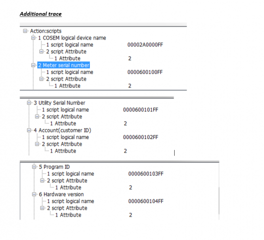

swap_1711
4 years 8 months ago
In reply to Hello, by swap_1711
Additonal trace
Additonal trace
No, that trace is not useful, but the source address looks like 17 (0x11). There is no disconnect control in your pictures. Are you sure that you can use disconnect control with Low-level authentication? It might that you need to use High-Level authentication to access it.

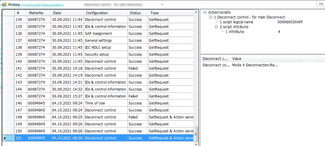

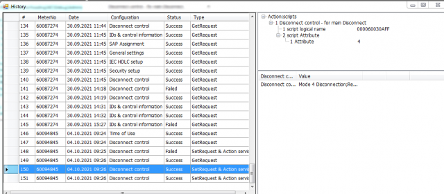

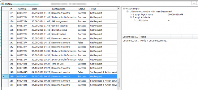

Below is the similar trace for disconnector control with same LLS authentication
04-Oct-21 9:26:08 AM Open service, IEC62056-46.
04-Oct-21 9:26:08 AM Remote IP: 192.168.10.1 Remote port: 4059.
04-Oct-21 9:26:10 AM Socket opened.
04-Oct-21 9:26:10 AM MeterNo = 60094845.
04-Oct-21 9:26:10 AM Get: Disconnect control - for main Disconnect.
04-Oct-21 9:26:10 AM GetService: GetRequestNormal, {70, 0.0.96.3.10.255, 4}.
04-Oct-21 9:26:10 AM Get service success.
04-Oct-21 9:26:10 AM Release service.
04-Oct-21 9:26:11 AM Socket closed.
04-Oct-21 9:26:25 AM Open service, IEC62056-46.
04-Oct-21 9:26:25 AM Remote IP: 192.168.10.1 Remote port: 4059.
04-Oct-21 9:26:27 AM Socket opened.
04-Oct-21 9:26:27 AM MeterNo = 60094845.
04-Oct-21 9:26:27 AM Set: Disconnect control - for main Disconnect.
04-Oct-21 9:26:27 AM SetService: SetRequestNormal, {70, 0.0.96.3.10.255, 4}.
04-Oct-21 9:26:27 AM Set service success.
04-Oct-21 9:26:28 AM ActionService: ActionRequestNormal, {70, 0.0.96.3.10.255, 1}.
04-Oct-21 9:26:28 AM Action service success.
04-Oct-21 9:26:28 AM Release service.
04-Oct-21 9:26:28 AM Socket closed.
04-Oct-21 9:26:37 AM Open service, IEC62056-46.
04-Oct-21 9:26:37 AM Remote IP: 192.168.10.1 Remote port: 4059.
04-Oct-21 9:26:39 AM Socket opened.
04-Oct-21 9:26:39 AM MeterNo = 60094845.
04-Oct-21 9:26:39 AM Set: Disconnect control - for main Disconnect.
04-Oct-21 9:26:39 AM SetService: SetRequestNormal, {70, 0.0.96.3.10.255, 4}.
04-Oct-21 9:26:39 AM Set service success.
04-Oct-21 9:26:39 AM ActionService: ActionRequestNormal, {70, 0.0.96.3.10.255, 2}.
04-Oct-21 9:26:40 AM Action service success.
04-Oct-21 9:26:40 AM Release service.
04-Oct-21 9:26:40 AM Socket closed.
swap_1711
This is SET request (remote
This is SET request (remote disconnect)
swap_1711
This is SET control (remote
This is SET control (remote re-connect)

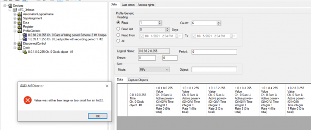

I was adding the profileGeneric objects, and when I read the below object it reads, but where do I see the values?

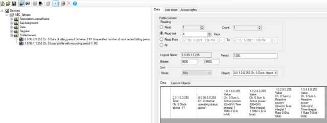

Further to my query, I was adding below objects under "ProfileGeneric", is this the correct way..?
Profile values 30 mins
05-Oct-21 1:05:12 PM Open service, IEC62056-46.
05-Oct-21 1:05:12 PM Remote IP: 192.168.10.1 Remote port: 4059.
05-Oct-21 1:05:13 PM Socket opened.
05-Oct-21 1:05:14 PM MeterNo = 60094845.
05-Oct-21 1:05:14 PM Get: Load Profile–cumulative.
05-Oct-21 1:05:14 PM GetService: GetRequestNormal, {7, 1.0.99.1.1.255, 3}.
05-Oct-21 1:05:14 PM Get service success.
05-Oct-21 1:05:14 PM GetService: GetRequestNormal, {7, 1.0.99.1.1.255, 4}.
05-Oct-21 1:05:14 PM Release service.
05-Oct-21 1:05:14 PM Socket closed.
Daily billing profile
05-Oct-21 1:06:36 PM Open service, IEC62056-46.
05-Oct-21 1:06:36 PM Remote IP: 192.168.10.1 Remote port: 4059.
05-Oct-21 1:06:38 PM Socket opened.
05-Oct-21 1:06:38 PM MeterNo = 60094845.
05-Oct-21 1:06:38 PM Get: Billing Profile(Daily).
05-Oct-21 1:06:38 PM GetService: GetRequestNormal, {7, 0.0.98.2.0.255, 3}.
05-Oct-21 1:06:39 PM GetService: GetRequestNext(BlockNumber = 00000001).
05-Oct-21 1:06:39 PM Get service success.
05-Oct-21 1:06:39 PM Get: Active energy import (+A) [kWh].
05-Oct-21 1:06:39 PM GetService: GetRequestNormal, {3, 1.0.1.8.0.255, 3}.
05-Oct-21 1:06:39 PM Get: Active energy import (+A) rate 1 [kWh].
05-Oct-21 1:06:39 PM GetService: GetRequestNormal, {3, 1.0.1.8.1.255, 3}.
05-Oct-21 1:06:40 PM Get service success.
05-Oct-21 1:06:40 PM Get: Active energy import (+A) rate 2 [kWh].
05-Oct-21 1:06:40 PM GetService: GetRequestNormal, {3, 1.0.1.8.2.255, 3}.
05-Oct-21 1:06:40 PM Get: Active energy import (+A) rate 3 [kWh].
05-Oct-21 1:06:40 PM GetService: GetRequestNormal, {3, 1.0.1.8.3.255, 3}.
05-Oct-21 1:06:40 PM Get: Active energy import (+A) rate 4 [kWh].
05-Oct-21 1:06:40 PM GetService: GetRequestNormal, {3, 1.0.1.8.4.255, 3}.
05-Oct-21 1:06:40 PM Get: Active energy export (-A) [kWh].
05-Oct-21 1:06:40 PM GetService: GetRequestNormal, {3, 1.0.2.8.0.255, 3}.
05-Oct-21 1:06:40 PM Get: Active energy export (-A) rate 1 [kWh].

meter returns values, when I select "Read" and give the count. "Range" and "Read last" (no.of days) does not return any values.
PC Time zone is UTC+4, and "Use UTC time zone, not standard" is unchecked.
Also the second object which is daily billing profile 0.0.98.2.0.255. I get error (attached).
please advise.
I believe that meter expects that the start and end times are in a specific format.
You can try to select "Ignore Time Zone" and/or "Ignore Time Status" from Advanced tab.
You can also try to check "Use UTC time zone, not standard".

Nope, it replies only when I select "Read" with counts, does this option uses any specific formats, compared to other reading options?
Would appreciate if you could assist in the question I asked regarding reading of other profile 0.0.98.2.0.255, screenshot i had shared in previous reply

Could you assist in below error
"Value was either too large or too small for an Int32"
"Value was either too large or too small for an Int32" is coming because the meter returns data that can't fit Int32. If you add a hex trace from this, I can check what is the problem.

GXDLMSDirector 8.1.2104.0801
Log created 9:10:24 AM
9:10:32 AM Read object type ProfileGeneric index: 1
7E A0 1C 00 02 4A FB 23 10 EB 9A E6 E6 00 C0 01 C1 00 07 00 00 62 02 00 FF 01 00 64 3B 7E
9:10:32 AM
7E A0 1B 23 00 02 4A FB 30 6E 51 E6 E7 00 C4 01 C1 00 09 06 00 00 62 02 00 FF 17 11 7E
9:10:32 AM Read object type ProfileGeneric index: 4
7E A0 1C 00 02 4A FB 23 32 FB 98 E6 E6 00 C0 01 C1 00 07 00 00 62 02 00 FF 04 00 DC 45 7E
9:10:32 AM
7E A0 18 23 00 02 4A FB 52 14 B9 E6 E7 00 C4 01 C1 00 06 FF FF FF FF E4 EB 7E
System.OverflowException: Value was either too large or too small for an Int32.
at System.Convert.ToInt32(UInt32 value)
at Gurux.DLMS.Objects.GXDLMSProfileGeneric.Gurux.DLMS.Objects.IGXDLMSBase.SetValue(GXDLMSSettings settings, ValueEventArgs e)
at Gurux.DLMS.GXDLMSClient.UpdateValue(GXDLMSObject target, Int32 attributeIndex, Object value, List`1 columns)
at Gurux.DLMS.GXDLMSClient.UpdateValue(GXDLMSObject target, Int32 attributeIndex, Object value)
at GXDLMSDirector.GXDLMSCommunicator.Read(Object sender, GXDLMSObject obj, Boolean forceRead)
at GXDLMSDirector.MainForm.Read(Object sender, GXAsyncWork work, Object[] parameters)
Your meter is returning 4294967295 seconds (FFFFFFFF) as the capture period. If capture is not used it should be Zero.
The capture period is changed from int to UInt32 in the next version so this is not causing problems to you anymore, but you should check if this is the correct value.
swap_1711
The capture period should be 86,400 seconds (daily, EOB). I am able to retrieve this in the AEC tool..

I agree with you. If the meter is read once a day the value should be 86400 seconds (0x15180). Now meter returns 0xFFFFFFFF. This is a custom value of AEC and not a standard DLMS value.
Is the meter working correctly if you write 86400 to the capture period?
Here is data converted as hex.

The capture period is changed for UInt32 so this error is not shown anymore.
What I mean is what happens if you try to set 86400 to capture period value with AEC tool? Or is it possible?

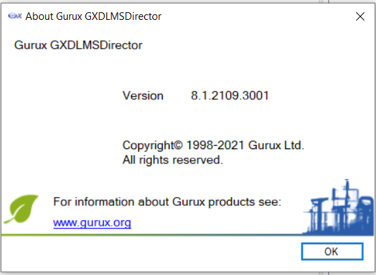

The version should be 8.2.2111.1801. Download the latest version from the download page if you are using the old version for 3.5.
