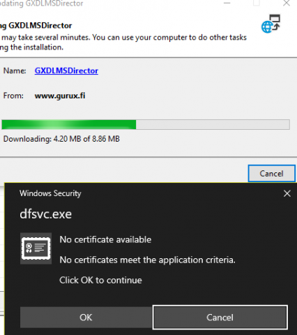

I am trying to update Gurux but getting the error. Snap attached.
I have also tried a new installation but the same is occurring.

after clicking OK, i am
after clicking OK, i am getting following error(attached)

Can you click the details and add them here. I believe that your PC is not supporting some localized settings.
