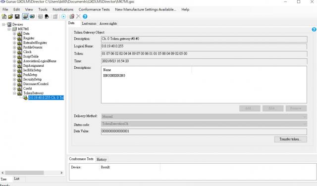

I use Gurux to get token gateway code and it works.
Now I`m trying to use Arduino IDE to get token data,but I got something error.
