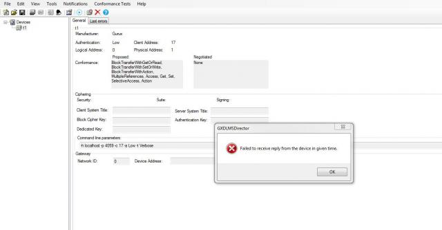

Would like to know the setting for Gurux meter and how to read the data in Gurux Director
I am getting "Failed to get reply from the meter"
Guidance is needed to read the meter data
4 years 11 months ago
If you are reading Java example server your TCP/IP port must be 4061.
