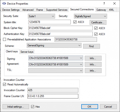

Dear Sir,
Dear Sir,
Tested with updated gurux director.
All settings are done as per your suggestions but not found Digital signing Tag and digital signature appended at the right of the message.
Frames seems as like suite0.
following is the log. also attached the setting snippet.

Hi Aoudumbar,
Hi Aoudumbar,

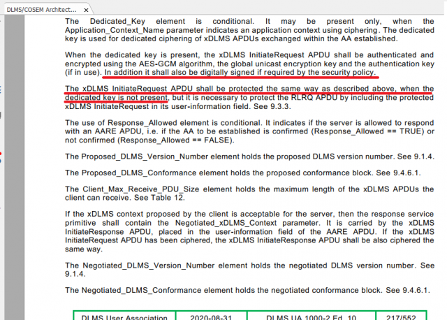

General signing messages are started to use after the connection is established. You have successfully established the connection. Have you tried to read some data? For example, the data object?

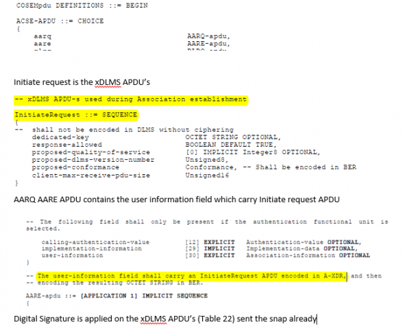

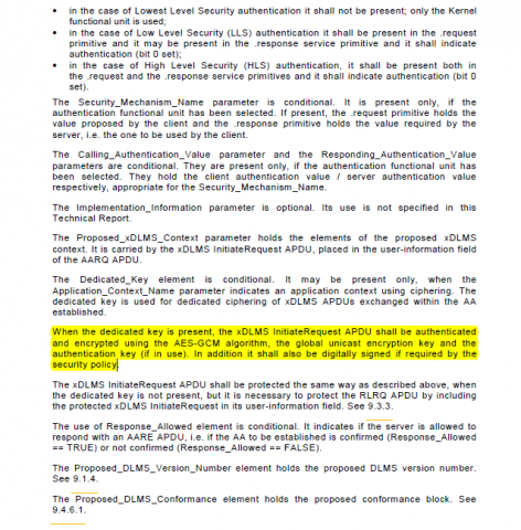

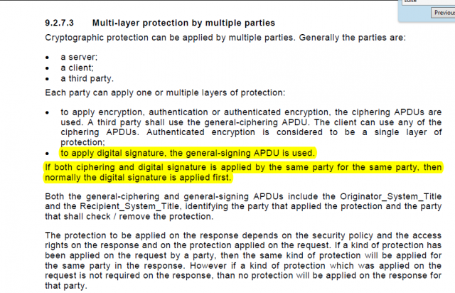

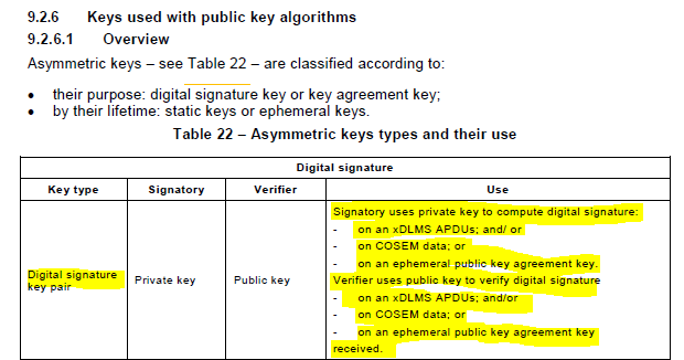

Dear Sir,
Dear Sir,
can share the sample log?
Also in out meter we are applying general signing APDU's to AARQ,AARE and authentication frames.

You are right. The digital signature is using private key already in AARQ and AARE when Key agreement doesn't. This is easy to fix and test because it will affect only one line. The new version is released latest tomorrow.

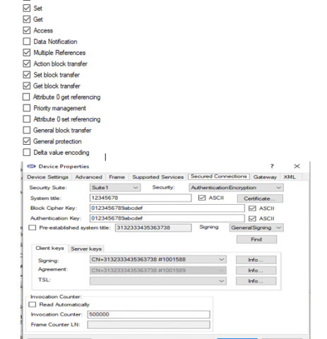

Dear Sir,
Dear Sir,

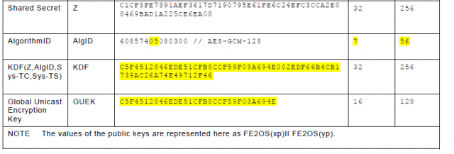

Can you share the one data frame in Hex format so I can check that we are sending the data in the same format? If it's possible, it will make everything faster.

Please find the below successful log of the Key Agreement method between kalkitech client and out meter with suite1

DLMS standard says that general-signing is using the Signing key (Asymmetric key) for ciphering the data.
This can be easily read from Table 36 – Ciphered xDLMS APDUs.
Your current meter and the client application are using Block cipher and authentication keys (symmetric key) and this is not correct.
You need to inform the meter manufacturer of this issue.
You should receive public and private key certificates that are used to communicate with the meter.
Because I realize that changing this will take a long time, I think if I can find a way to handle this before this is implemented for the meter.

aoudumbarpawar
4 years 11 months ago
Dear Sir,
Dear Sir,
Please go through the attached snippet of the green book.
AP

Just to make sure. Are you supporting anything other than the Ephemeral Unified Model scheme (One-Pass Diffie-Hellman or Static Unified Model)?

Right now we are only using the Ephemeral Unified Model scheme by invoking the "key agreement" method of the security setup class.
AP
If you are using Ephemeral Unified Model then the key must be 64 bytes long. Now the client is sending 16 bytes long authentication key. Check Security setup key_agreement from Blue Book.
You can get an example from Green Book: Table C. 1 – Test vector for key agreement using the
Ephemeral Unified Model C(2e, 0s, ECC CDH) scheme
aoudumbarpawar
Hii Sir,
Hii Sir,
Good Morning!!!
For suite1 DLMS recommends AES-GCM-128 algorithm so 128/8 = 16 => key size should be 16 bytes
similarly for suite2 DLMS recommends AES-GCM-256 algorithm so 256/8 = 32 => key size should be 32 bytes.
64 bytes is nothing but the signature generated for the message and appended right to the message.
Also go though the snap attached for the table c.1 , if you observe the yellow highlighted you found that encryption key agreed is of 16 bytes.
C.1 table explains the procedure of key agreement method for encryption key.

GUEK is coming from the first 16 bytes from KDF. KDF is count from the shared secret, algorithm ID, and system titles.
I remember when I was solving this for Java several years ago. This took a long time to solve.

The new version was released last week where support for General Signing is added.
Check the Quick Start video from here:
https://youtu.be/h90y4qimLOs

I'm just reading the Breen Book and try to find the answer should AARQ/AARE sign or not. Content is not signed with Ephemeral Unified Model scheme, One-Pass Diffie-Hellman, or Static Unified Model before the connection is established for the meter.

AARQ /AARE has many components/information in it. one of the component is named as User Information.
Also AARQ/AARE contains the CtoS/StoC challenge values.so i thought xDLMS APDU-s supporting ciphering/signing shall include in it.

AARQ and AARE are ciphered using authentication key and block cipher key. For example, dedicated messages start to use a dedicated key for ciphering AFTER the connection is made. But, I'm trying to find an answer if GeneralSigning starts to use the signing key before the connection is established.

Please go through the attached snap may help you.
AP
aoudumbarpawar
Hii,
Hii,
Please go through the attached snap.
As AARQ contains the user information field which carry Initiate request APDU which is nothing but the xDLMS APDU.
As per table 22 (which snap already sent) digital signature applies to the xDLMS APDU.
so the signature must be applicable for the AARQ/AARE.
AP

The digital signature is a little bit confusing, but at the moment I think that digital signature is used after the connection is established. We have a meter that is passed DLMC CCT and it doesn't use a digital signature before the connection is established.
So GXDLMSDirector works correctly at the moment.

is the digital signature applicable for authentication frame ( GMAC authentication frame after AARQ/AARE)?
AP
4 years 10 months ago
If you are using High authentication level it's added after the meter has accepted the connection.

Hii,
Hii,
Please go through the attached snap which proves that Digital signature is applicable for xDLMS initiate request APDU if digital signing is required by the security policy.
AP
aoudumbarpawar
Hii,
Hii,
Please find the correct highlighted snap.
AP
Your findings are interesting and when I read them, I believe that you are right. If I understand correctly, AARQ is encrypted with a block cipher and the authentication key, but it's also digitally signed.
I need to think about this.

Also which one of the following would be the better and easy for implementation (Embeded c) to import and export the certificate of hug length when frame size negotiated is small say 200 bytes.
1. Action request / response with block
2. Segmentation
Ap
aoudumbarpawar
Hii,
Hii,
Also may i know when to release.
AP
I'm waiting for the feedback from the new release. I hope that it can be release today or tomorrow.
aoudumbarpawar
Hii,
Hii,
Just got the update of gurux, is this release has the signing for initiate request?
I found one new setting of checkbox to enable disable general signing for initiate request, but in AARQ not found the signature for both enable/disable.
Also may i know how to check the revision history for new release in gurux?
Thank you:)
AP
There is a new version where AARQ is not signed. We have two meters that have passed DLMS CTT and Neither signs the AARQ. DLMS Standard says that it's possible, but doesn't say how to sign it.
I'm still reading the DLMS standard and try to find the answer for this.
aoudumbarpawar
4 years 9 months ago
Hii,
Hii,
We confirmed from DLMS support and other some DLMS experts that signining is applicable for AARQ as well.
Following is the reply from DLMS against my query:
It depends what security policy is specified - see Green Book 10, clause 9.2.7.2.2.
If bit 4 is set, then, yes, you need to sign the request, if not, you don't.
Best Regards,
Aoudumbar pawar
9.2.7.2.2 refers to Security Suite 1. and the access rights of the object. It will describe is the attribute of the COSEM object signed or not.
I'm sorry to say, but it doesn't tell anything from the signing AARQ/AARE.
