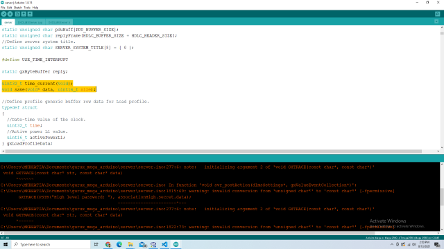

I have a suggestion though. The arduino code does not compile straightaway. But the only change I needed to make it work is to declare two function prototypes at the top of server.ino file as in the attached image. If possible please add this to the git repo as It would make it easier for people to start with the library. Otherwise the compiler shows a lot of unrelated errors.
