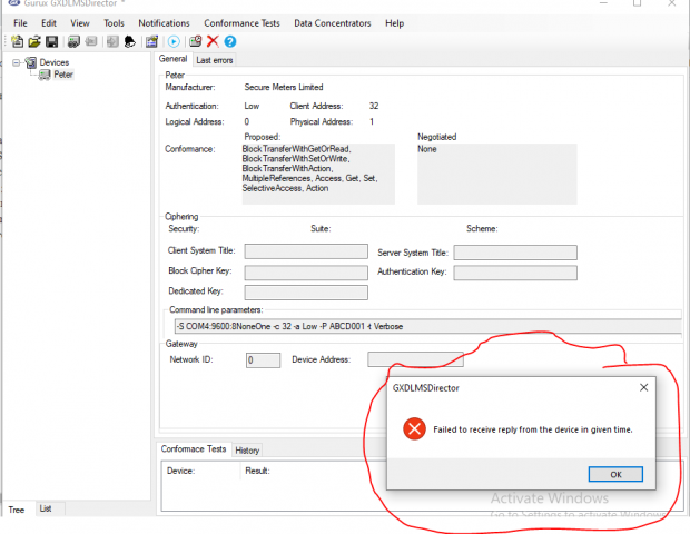

Please I have been trying to connect to a Premier 300 without success. Please kind see attached picture for the set up. Your kind guide on how get it done will be appreciated. Also, find below the trace:
10:09:12 Send SNRM request.
TX: 7E A0 07 03 41 93 5A 64 7E
10:09:17 Data send failed. Try to resend 1/3
10:09:22 Data send failed. Try to resend 2/3
10:09:27 Failed to receive reply from the device in given time.
10:09:27 Send Disconnect request.
TX: 7E A0 07 03 41 53 56 A2 7E
10:09:32 Data send failed. Try to resend 1/3
10:09:37 Data send failed. Try to resend 2/3
10:09:42 Failed to receive reply from the device in given time.

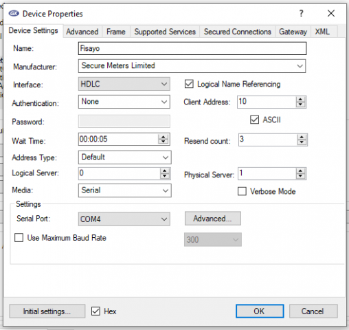

Please I am using GXDLMSDirector version 8.2.2107.2101. I notice that there is no field for "start protocol" on both the Manufacturer's and Device Properties. Please see attached screenshot. Is there an explanation as to why that is missing?

Please, don't add error pictures. They don't give any extra info and pics are hard to read because of compression.
If you are using the optical probe, you must select Interface HrlcWithModeE and if you are using serial port you must select HDLC.
