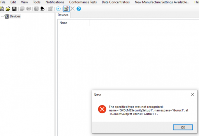

When we open .gxc file in new Gurux DLMS director getting error, as shown attached in .jpg file,
please tell how to open old created files 1 months back

I'm sorry about this. GDLMSSecuritySetup1 was a bad idea and it's rejected back to generic GDLMSSecuritySetup. For a fast fix, you can open the .gxc file and rename GDLMSSecuritySetup1 to GDLMSSecuritySetup. This is fixed for the next release.
