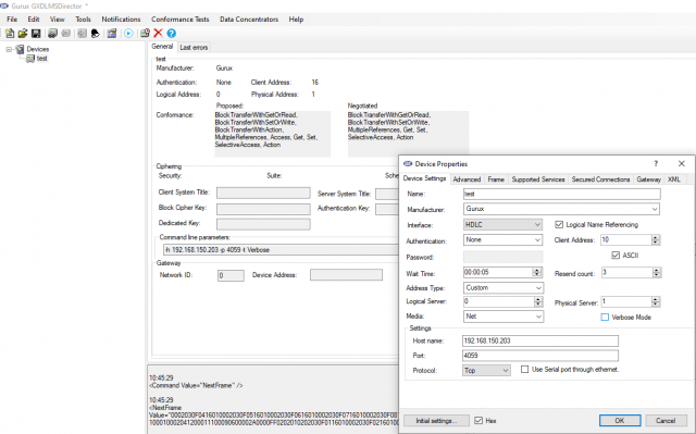

Hi, Colleguaes
I used old version GXDLMSDirector and successeful connected to my DLMS device. After upgrade to V8.2.2.106 1501 I am not able to connect to my device and read data. I receive error
System.ArgumentOutOfRangeException: Specified argument was out of the range of valid values.
Parameter name: access
at GXDLMSDirector.MainForm.RefreshDevice(GXDLMSMeter dev, Boolean bRefresh)
at GXDLMSDirector.MainForm.Refresh(Object sender, GXAsyncWork work, Object[] parameters)
Help me, please, what does it mean this error?
My settings is on the screen. Log of connection is below

Your meter is not returning an association view and it's mandatory. You should ask the meter manufacturer to add it. We'll add a check for the next version, so you can read the meter.
Andrey
5 years 3 months ago
Unfortunately, I am not agree
Unfortunately, I am not agree with thesis, that this meter don't return association view. You can see from exchange log, that meter answered on the request attribute 2 of association object (object-list). And all old version GXDLMSDirector could receive and understood list of object from this meter. We saw list objects from this meter in all old version GXDLMSDirector. Our question started after update GXDLMSDirector up to 8.2.2106.1501. Decoded answer of meter is below (from Gurux DLMS translator). Maybe version 8.2.2106.1501 has new rules to check this answer and we need correction meter or GXDLMSDirector setup?

You are right. I was using the new version and it's released in the next week. This is fixed for that version.
в GXDLMSDirector.MainForm.RefreshDevice(GXDLMSMeter dev, Boolean bRefresh)
в GXDLMSDirector.MainForm.Refresh(Object sender, GXAsyncWork work, Object[] parameters)
Andrey
Hi Mikko
Hi Mikko
Could you told me, do you have any ideas about reasons, why new version GXDLMSDirector can't work with our device? Old versions worked fine with these devices
Andrey
Hi Mikko
Hi Mikko
I updated GXDLMSDirector to up version 8.2.2107 2101. But I have the same error message. GXDLMSDirector for .NET 3.6 works fine. But new version GXDLMSDirector can't work with our device. Old versions worked fine with these devices. I need your help with GXDLMSDirector.
We try to solve why this is happening. I'll let you know as soon as I have more information.
The reason why this fails is that your association view version is 1 and method access mode is 3. access_mode range is from 0 to 2 in Version 1. You need to fix this.
<Array Qty="01" >
<Structure Qty="02" >
<Int8 Value="01" />
<Enum Value="03" />
</Structure>
Andrey
Hi, Mikko
Hi, Mikko
You're right. A lot of thanks you. Could you told me, did old version director didn't check it?
This check was added in the spring. Version 3 is using bit-string instead of enum values. Some meters are using Association LN version 3 and old enum values and this was causing problems. This check was added because of that.
