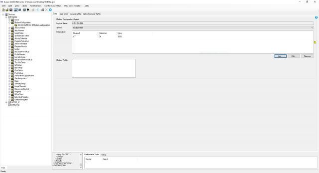

In order to configure SMS Push notification, I have to set Initialization string in the Modem configuration object (0-0:2.0.0.255).
But when I click on Add button nothing happens. All other parameters can be set without any problems.
Additionally, I have check Access rights and Read, Write access is available for all attributes.
There are no errors in GXDLMSDirector.log and LastError.log.
Smart Meter that I am using is Iskraemeco ME382-D1.
Screenshots are attached.
Please let me know if you need any other info.

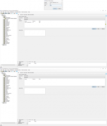

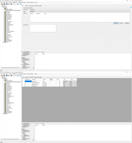

Unfotunetally correction is not working.
Now I can add value to the Modem configuration (0-0:2.0.0.255) initialization string, but the value doesn't seem to be properly stored, because when I try to read the saved value initialization string is empty.

yes I have, check the attached GXDLMSDirector.log: https://pastebin.com/BS3unhaZ
11:25:27 Writing object 0.0.2.0.0.255, interface ModemConfiguration
I even tried it again on my ME382-D1 meter and the behaviour is the same.

We have the same versions. I can't read from the picture, so can you add plain text what are the request and response messages? Can you try to add example AT and OK? Will they work?

I tried to set up the
I tried to set up the following
Request: AT
Response: OK
Delay: 3000
Result is the same, there is nothing when I tried to read Initialization string from Modem configuration object.

I checked your set message and the initialization array is empty. When I try to write there is data. We'll check what is causing this.
4 years 10 months ago
This is fixed. Adding a new initialization string fails if the array is empty. There will be a new version today where this is fixed.
