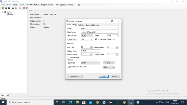

i am new to fetch the meter reading data from dlms lnt meter using the optical port so now i am facing the
problem
this is my view log GXDLMS Director:

image was setting for lnt GXDLMS settings so pls help me to get the solution
5 years ago
Your settings look correct and you can establish the connection to the meter and there should be no reason why the meter is not replying. Is the password correct? Can you connect with public authentication?
