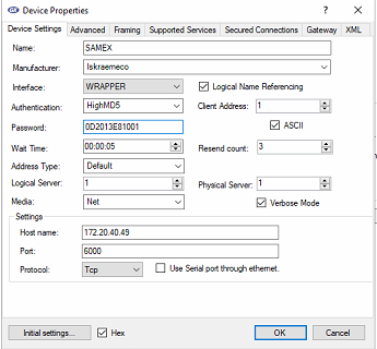

I have two identical IskraEmeco meters.
In Meterview(software from producer) they are identical and both works fine.
Im trying using GXDLMSDirector to connect to both of them.
One works always but the second one gives me always "Authentication required" error.
Of course password is 100% correct.
Settings from director below.
Any idea ?
5 years 1 month ago
I believe that one of your settings is wrong. Can you get a hex trace from the message that Meterview is sending? I can check what setting is invalid. You can get the log from the sent and received messages at Meterview.
