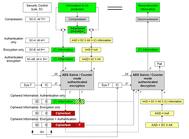

Hereafter is picture from DLMS green book
5 years 3 months ago
Data is not ciphered In authentication only mode. For this reason, only the authentication key is needed.
This picture is not very good and there is too much information. Its main purpose it demonstrates how the security control byte is constructed.
VitalyP
Chiper (with EK) have to be used in Authentcation-only mode to get Authentication Tag (T is not equal to A)).
GXDLMSDirector throws "index was outside the bounds of the array" exception in GMAC authentication-only mode, if BlockCiperKey has never been set.
This is changed as it was. Get the latest version.
