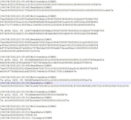

you find in attachement file all pdu changed log to connect with sagemcom
with FLAG (snipher wtih other limited app) .
i want to do the same work with GWDLMSDirecotr but we have not the same name
of parameteres :

Please, don't add images in the future. It's a pain to read the bytes. Add plain text.
Set parameters:
client address: 2
physical server: 0x10
Logical server: 1
Set also max payload size in transmit and receive to 1024 in "Frame" tab.
Set also challenge to f50ab847e31d96c2a5f6b3e901e24a18. This should be random number, but try first with the static value.

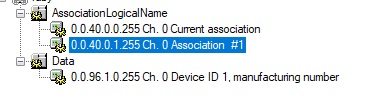

Exactly,I create a new manufacturer like SagemCom with SAG FLAG_ID and i can to succed in Association LogicalName and Data Field.
Next Step :i cant associate with meter (i dont have many ideas to use GXDLMSDirectory)
Rq: Differents parameters to set
how can i decode and insert in GXDLMSDirectory
5 years 6 months ago
