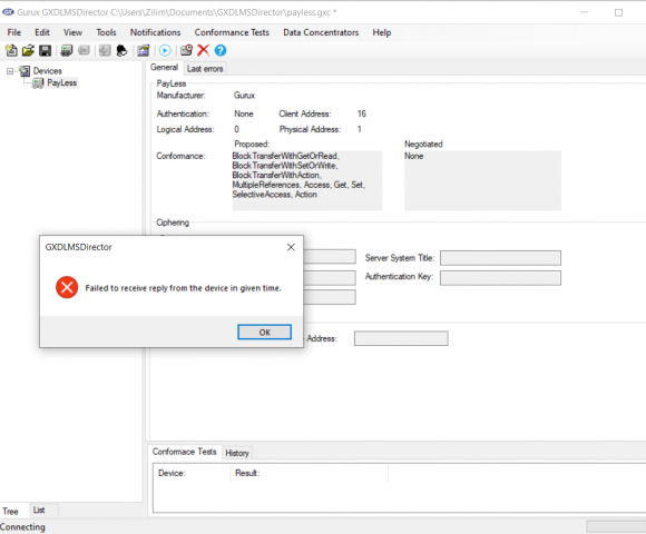

Helo Kurumi,
Helo Kurumi,
I'm trying to simulate the connection with Gurux.MQTT and GXDLMSDirector. But it shows the error on the attached photo. The broker is running in the default port with a localhost address.
5 years 5 months ago
Try to read the meter with GXDLMSDirector using serial or TCP/IP port first. If one of your meter settings is wrong, the meter doesn't reply. For this reason, it's impossible to say why the meter is not answering.
zilic
5 years 4 months ago

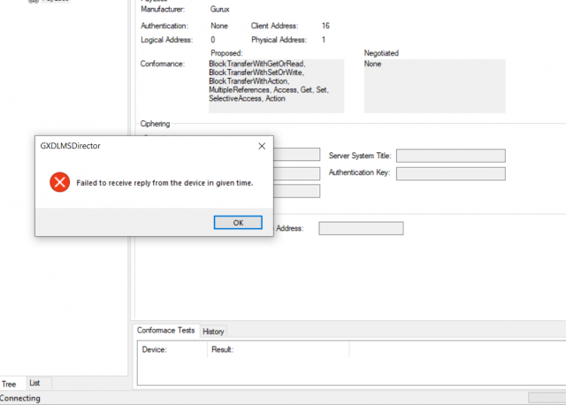

Still, I'm receiving errors
Still, I'm receiving errors even using a serial port. But by using the Meter Vendor [DonSun] application I can be able to connect via Serial port.
Note: The Meter setting is ok.
zilic
I have installed the
I have installed the Mosquitto broker in my server and I'm running the GuruX bridge but still, I'm receiving the errors. What could be the issue/missing configuration?
One of your settings is invalid and the meter doesn't reply because of that.
Make the connection work with the serial port before try with MQTT.
If you can get a byte trace what the another application is sending and receiving I can get the correct parameters for you.
zilic
I tried to use the serial port but still, I was receiving the same error. But using the Manufacturer App the Meter can not to a serial port.
I can help you only if you can get a hex trace from send bytes. You can try to get bytes with fireshark and then convert them to hex.
https://www.wireshark.org/
