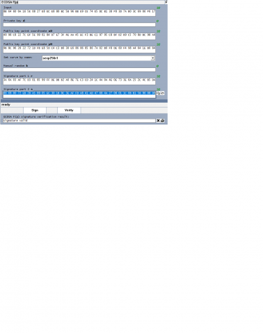

Following is the signature verification process:
Data used to calculate SHA-256 (TBS Certificate info):
30 82 00 7B 02 01 00 30 1B 31 19 30 17 06 03 55 04 03 0C 10 33 33 34 34 34 63 30 37 30 32 32 30 30 30 35 39 30 59 30 13 06 07 2A 86 48 CE 3D 02 01 06 08 2A 86 48 CE 3D 03 01 07 03 42 00 04 49 98 C8 22 7C EF 5E 99 61 84 D7 E7 3F 4E AA 45 EC F3 BE C1 97 95 C8 BF D2 B9 C5 70 8D BC 98 A4 9B 8C 96 28 22 72 1D FB E8 5D C4 C3 B0 30 E6 86 86 85 86 7A 02 B0 F8 DE 60 F4 98 A4 64 1E B0 84
Result of SHA-256 of TBS info:
8B 64 60 0A 16 5E 08 27 E8 EC E8 80 BC 5B 96 BB E9 CE 74 E5 DC B1 38 F8 3D 7A B0 3C 69 06 F6 17
Inputs used to verify the signature:
1. SHA-256 above
2. Public key: (in the certificate info)
3. Signature : (calculated over TBS cert info):
3A 6A 03 AF 7C D3 01 85 99 FF DE DB B2 A6 8E 7E C3 CD 24 1C 4A 0A 4E 0E 73 3E 6A 25 2C 4C B5 DA
86 68 00 72 EB 2D A5 89 05 EC 30 1B 0C 3E AF FD A8 41 AD 47 68 4A 27 08 01 1C 0B B1 5B 96 08 D6
Signature verification result: Valid
Also find the snap of signature verification.
Also can suggest which fields are mendatory and which fields are optional in tbscertificate.
5 years 5 months ago

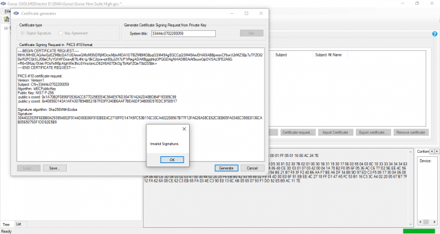

Able to get CSR successfully but now when click on "Generate" button gurux throws an error of "Invalid Signature", please suggest what is going wrong.
Below is the log and snap is also attached:
22:55:42
TX: 7E A0 1E 00 02 BA 69 61 54 4C 97 E6 E6 00 C3 01 C1 00 40 00 00 2B 00 01 FF 05 01 16 00 AC 24 7E
22:55:43
RX: 7E A0 ED 61 00 02 BA 69 74 8C 36 E6 E7 00 C7 01 C1 00 00 09 82 00 D5 30 81 D2 30 7B 02 01 00 30 1B 31 19 30 17 06 03 55 04 03 0C 10 33 33 34 34 34 63 30 37 30 32 32 30 30 30 35 39 30 59 30 13 06 07 2A 86 48 CE 3D 02 01 06 08 2A 86 48 CE 3D 03 01 07 03 42 00 04 1A 70 B2 F0 85 6F 05 36 AC C6 77 D2 9E EE 4C 56 4E 97 6D 30 47 61 42 42 D4 8B DB 4F 1E 08 5C 98 40 85 6D 14 3A 1A FA 30 7B 94 BE 21 B7 F8 3F F2 40 B6 AA F7 BE A6 DF 34 B8 9D 97 ED C3 F5 89 17 30 0A 06 08 2A 86 48 CE 3D 04 03 02 03 47 00 30 44 02 20 25 F6 EB B0 42 93 95 48 02 F9 14 4D 80 E8 6F 91 EB EE 4C 27 18 FF D1 47 A5 FC 53 B1 16 C3 3C A4 02 20 85 67 B7 7F 12 FA 62 6A 08 CE 62 C3 EB 65 FA 03 4E C3 90 E8 13 6C AB 05 65 07 93 F1 DD 92 E5 B9 AC 11 7E

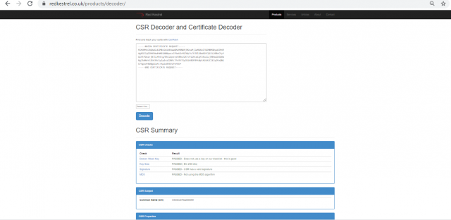

When i verified CSR generated using following Link then it shows valid signature:
Link : https://redkestrel.co.uk/products/decoder/
Regards,
Aoudumbar Pawar
Hi Aoudumbar,
Hi Aoudumbar,
This is updated and we are just testing this. You can use your certificate with the next version.
It's released this week as soon as tests are over.

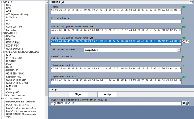

Following is the processure of certificate signature verification (client dig. sig, certificate)
1. Extract the TBS certificate data from received certificate for import:
30 82 01 1A A0 03 02 01 02 02 03 40 46 0F 30 0A 06 08 2A 86 48 CE 3D 04 03 02 30 4E 31 14 30 12 06 03 55 04 03 0C 0B 52 6F 6F 74 20 43 41 20 32 35 36 31 17 30 15 06 03 55 04 0A 0C 0E 47 75 72 75 78 20 53 65 63 75 72 69 74 79 31 10 30 0E 06 03 55 04 07 0C 07 54 61 6D 70 65 72 65 31 0B 30 09 06 03 55 04 06 13 02 46 49 30 1E 17 0D 32 31 30 34 31 33 30 39 33 30 35 30 5A 17 0D 32 32 30 34 31 33 30 39 33 30 35 30 5A 30 1B 31 19 30 17 06 03 55 04 03 0C 10 33 31 33 32 33 33 33 34 33 35 33 36 33 37 33 38 30 59 30 13 06 07 2A 86 48 CE 3D 02 01 06 08 2A 86 48 CE 3D 03 01 07 03 42 00 04 49 0D 97 90 92 F2 3D 6D 82 58 48 E8 AA FF CC E2 9F 5C 90 E1 24 B4 A1 38 BC 7E 95 DC E7 E2 AB B0 72 B3 C7 CB 78 31 9B 78 B0 30 1E EE DC 99 B6 3C C3 3D 52 E0 5D 89 C6 40 51 92 54 49 10 8A 7A F5 A3 1A 30 18 30 09 06 03 55 1D 13 04 02 30 00 30 0B 06 03 55 1D 0F 04 04 03 02 07 80
2. Calculate the SHA-256 of TBS certificate in step 1 (resultant digest is below)
94 9D 25 12 98 C4 D6 C3 59 9E 92 2F 6F 41 64 67 B4 24 CC 4B A0 36 D0 A3 D2 08 49 5A 8A 3C 0D 1D
3. Verify the certificate signature which is at the end of the certificate
3.1 Inputs used to verify the signature of the TBS certificate
3.1.1 SHA-256 digest calculated in step 2
3.1.2 Signature of the certificate
E7 04 27 B1 44 26 41 18 4C AC F4 E4 1E 1B A3 D7 91 A0 44 3A 0C A6 42 F3 E3 B5 E1 76 15 BC AB E3
F6 F5 17 41 59 F0 5B 36 9C 18 A6 AC E6 7F 0D D7 8B 90 17 F6 96 29 0A 9B D8 F5 BC A3 70 82 E9 33
3.1.3 Public key of the Gurux CA certificate
74 26 67 34 35 71 10 58 A4 42 A8 DA 10 77 21 65 93 35 C7 24 6D 70 31 5C 63 F4 47 E0 6C B2 F5 37
A2 9B A1 B5 4C E6 B6 CB 80 C9 1A 16 F0 C7 9F D4 B4 96 70 8B 91 40 43 87 1B 83 1D DF E1 A9 88 3A
signature verification result : Invalid signature

5 years 4 months ago
Your TBS certificate is in the wrong format. I hope this will help you.

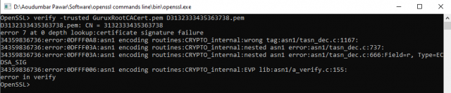

When i am trying to verify the gurux digital signature certificate using gurux root ca certificate in openssl i am getting error "error in verify"
Snap is attached.
Best Regards,
Aoudumbar Pawar
