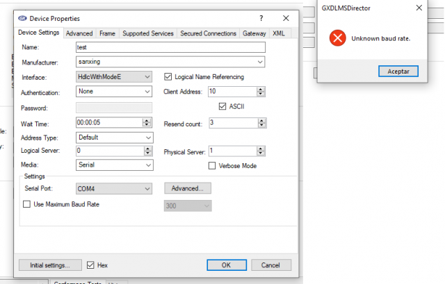

Hello, sorry for the delay, I
Hello, sorry for the delay, I was complicated at work.
try to read meter N12U02 again.
When I try to read it it tells me that the manufacturer is "? A?" and not "AUX" as stated for "Ningbo Sanxing Smart Electric Co."
What I do is create a new manufacturer with id "? A?"
after this I get "Unknow baud rate"
5 years 6 months ago
I believe that your serial port settings are wrong because the manufacturer same that the meter sends is invalid. Only the alphabet is allowed in the manufacturer's name.

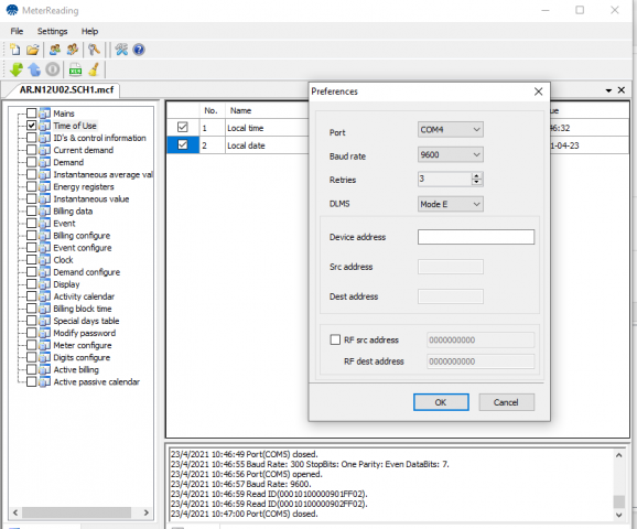

I understand, I suspected
I understand, I suspected this since in the original software it said IEC 62056-21, although in the configurations it says DLMS, but it does not provide many configurations. Attached photo of the settings.
Consult you do not know where I can obtain the documentation of the IEC 62056-21 protocol, so in this way I do some research and maybe make a python script to be able to obtain the data I need.
Thank you very much for your attention and your time.
