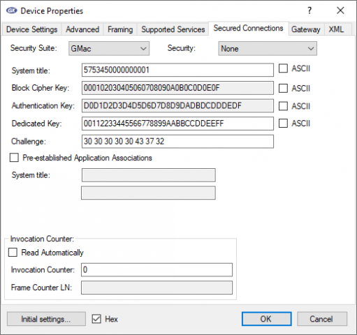

Clarified the parameters,
Clarified the parameters, registered. The settings are the same as in the screenshot.
Now the request is being formed:
00 01 00 01 00 01 00 44 60 42 A1 09 06 07 60 85 74 05 08 01 02 A6 0A 04 08 57 53 45 00 00 00 00 01 8A 02 07 80 8B 07 60 85 74 05 08 02 05 AC 0A 80 08 30 30 30 30 30 43 37 32 BE 10 04 0E 01 00 00 00 06 5F 1F 04 00 1C 03 20 FF FF
But the device resets it anyway.

In the log generated by the
In the log generated by the test utility - in what mode is the time reading? Authenticated and encrypted or not? P.S. Сannot see this in the utility itself.
5 years 3 months ago
In your picture above the Security is None. Try to change it to AuthenticationEncryption. Reading time depends on the meter model and how it's configured. You can usually read the time without authentication or ciphered connection, but it might be that the meter is configured in that way that only ciphered connections are allowed.

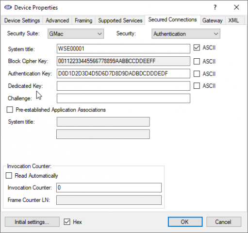

They sent me a document like
They sent me a document like this:
https://drive.google.com/file/d/1VR7qVsKjPNwmIYTsvuYSFPRME7MsUpu1/view?…
EK - Block cipher key?
AK - authentication key?
Dedicated key what is in this document?
System title- it says that the last 5 digits are the serial number for the server. Is it being asked somewhere in Dlms Director?
5 years 2 months ago
EK is the block cipher key and AK is the authentication key. Leave the dedicated key empty. Basically, you should be able to use any client system title, but use what they have proposed: WSE00001
Don't set meter system title. It's updated when the connection is established.

You should be able to leave it empty. Then it's generated for each connection.
Ingvar
Installed as in the
Installed as in the screenshot - the device does not respond at all.
Answer:
00 01 00 01 00 01 00 5F 60 5D A1 09 06 07 60 85 74 05 08 01 03 A6 0A 04 08 57 53 45 30 30 30 30 31 8A 02 07 80 8B 07 60 85 74 05 08 02 05 AC 12 80 10 04 61 12 49 4A 00 52 66 6C 5A 1C 35 56 70 37 1C BE 23 04 21 21 1F 10 00 00 00 00 01 00 00 00 06 5F 1F 04 00 00 1E 5D FF FF F6 2A FC 46 8A 39 AC 9F 70 D8 8B 88
The manufacturer gave the wrong keys?
I just notest that the meter is not using ciphering when the connection is established. It's starting to use ciphering when the first read is made. This is not correct. Even ciphering is used all the time or then it's not used at all.
You need to ask for the new firmware from the meter manufacturer where this is fixed.
