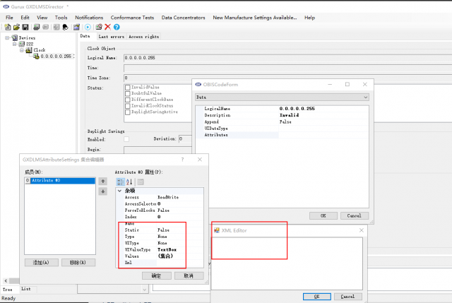

and how to set if i have to
and how to set if i have to read with some args?

953313493@qq.com
5 years 8 months ago
I am sorry, <Array Qty =“ 06”
I am sorry, <Array Qty =“ 06”>
I want to read like in xml client read , so how should I input in the GXDLMSDirector
953313493@qq.com
or like follow , how shoud
or like follow , how shoud i input in GXDLMSDirector
You don't need to do anything. If you just read the value from the meter you can see it like the picture below. After the read, you can modify it and write back.
