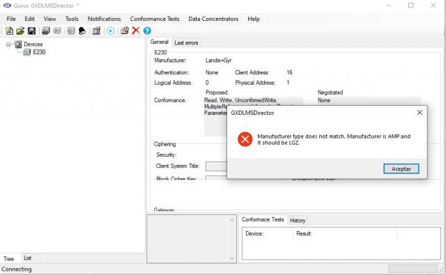

i am trying to read this meter (Landis Gyr E230)
as the first instance, I create a new device and select "Landis + Gyr"
When trying to read, I get the error that the manufacturer does not match, it appears as "AMP", the meter is manufactured in Brazil (2017). As seen in the photo.
to solve this I create a new manufacturer, with "Flag ID" = "AMP", and I leave it the same as the original Landis + Gyr.
After this I try to read the meter and I can't do it, the meter does not respond, I am doing it through an optical sensor, the protocol is IEC, which I have seen that in the new version it does not appear to select, I have tried with a version above but I have not been able to read it either.
I think that something manages to read at the beginning even though it does not appear in the tracert, since it identifies the manufacturer.
Any idea what it could be?
5 years 7 months ago
Select interface to HhlcWithModeE if you are working with optical probe and try again.
