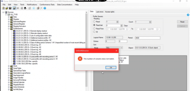

Hi All,
We are trying to read the load profile with Gurux Director but we are getting an error during the process, we can connect and read other registers, but with the load profile we have the error that you can check in the picture.
also we attached the frames log, according with the manufacturer the send and receive frames are ok.
We hope some can help us.
Juan Jose
