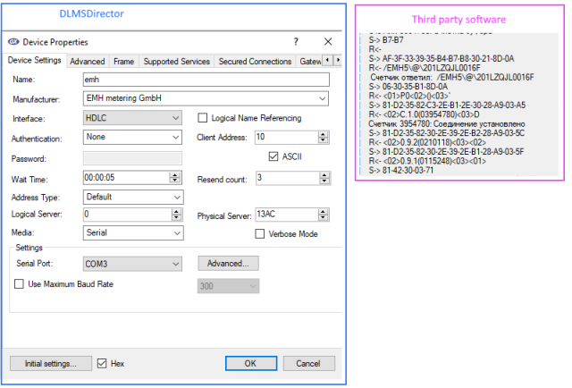

I have emh lzqj-xc (with "dlms" label), but I can't connect to meter via DLMSDirector. I connect with parameters below, but connection is fail. Third party software connect to this meter successfully (see screenshot bellow), but messages does not looks like HDLC, isn't it? Which parameters of connection I must use to connect successfully via DLMSDirector?
5 years 9 months ago
Another app is using IEC 62056-21. It's an ASCII based protocol and you are right, it's not DLMS.

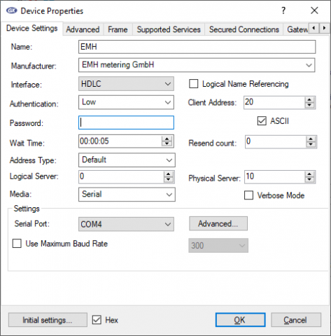

I did try with one version from EMH lzqj-xc. Try to change physical server to 10. You can see my settings in the pic.

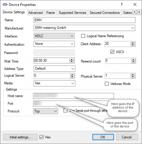

Would you mind telling me if there's anything I'm doing wrong? My parameters are as in the attached picture.
Try to change the physical server address from 1 to 10.

Try with this settings:
Client address: 20
Authentication: Low
Password:Default is 11111111
Physical Server: 10
