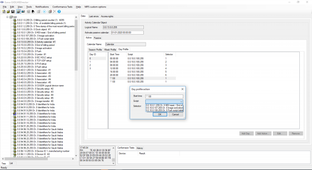

hi,
I read my meter data using gurux dlms director successfully and now i want to change activity calendar for day profile. When i click on passive day profile entries, UI appears with options "Start time" "script" and "selector", where in script is a drop down list and has "0.0.10.0.1.255", "0.0.10.0.107.255" and "0.0.10.0.108.255" items in it. I found that my meter accepts only "0.0.10.0.100.255" script. How can i get this script option, i need help on this.
Jay
5 years 11 months ago
This is true. You need to select Ch. 0 Tariffication script table here.
Ch. 0 Image activation and Push script table are not possible options here, but we can't filter them out, because DLMS standard doesn't define the list of possible OBIS codes.
