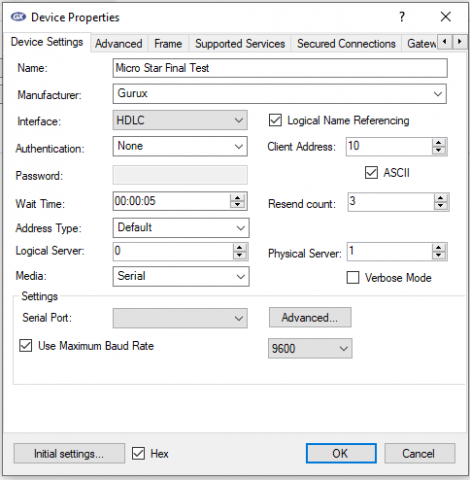

Hi Mikko and Team,
I am trying to establish connection between Microstar/ Bluestar A2000/ P2000-D three phase energy meter, and GXDLMSDirector software, but i am failing to. All i need is to make connection, then refresh to retrieve available OBIS Codes.
Please see attached my connection settings using "Gurux" manufacturer type.
If anyone has ever managed to make connection to these meters, please assist. Thank you in advance.
tumza
5 years 10 months ago
Serial Settings :
Serial Settings :
Baud Rate : 9600
Data Bits : 8
Parity : None
Stop Bits : One
Flow Control :None

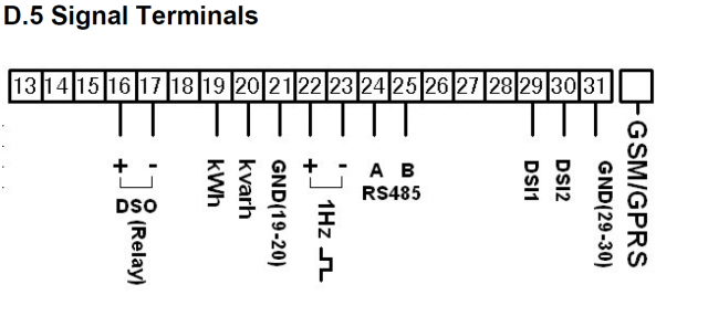

and attached below is the pinout on the meter itself. I have my converter's A to pin 24 on the meter, B to pin 25

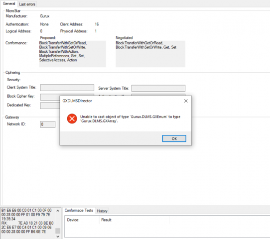

Seems like i made connection
Seems like i made connection but cannot retrieve objects when i press F5
19:08:08 Data send failed. Try to resend 1/3

tumza
I get this error message
I get this error message every time i try to collect objects.
Your settings are now correct. There is an issue with the meter. It doesn't send an object list as an array and this is wrong. You need to ask the meter manufacturer if there is a new firmware available that fixes this. Let me know If there is no update available and we can modify bytes and generate device template so you can read the values.
SebasJimenezIoT
1 year 10 months ago
Hi Mikko, Regarding with…
Regarding with your last response. Do you have any upgrade for GXDLMSDirector in order to proper connect with Microstar meter?
I am still having the message "Cannot convert an object of type 'Gurux.DLMS.GXEnum' to type 'Gurux.DLMS.GXArray'"
I have not been answered by the meter manufacter. I will appreciate any support.
Hi, It's hard to fix meter…
It's hard to fix meter issues with the GXDLMSDirector.
If you know what you want to read, it's possible to add COSEM objects manually.
You can try to add a clock object if you select "Edit" and "Add Object".
Then select clock and press OK.
You can now try to read the clock object.
