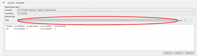

For the Monitored Value field in Register Monitor Object, (Attrib 3 of IC 21), the values from “Data”, “Register”, “Extended register” or “Demand register” objects can be selected.
But in Gurux, there is a drop down list which shows only "Data" & "Register" related objects and it does not show "Demand" & "Extended Register" related objects.
Is this understanding correct?
Can the support for IC 4 & IC 5 (i.e. "Demand" & "Extended Register") be added?
Anil
5 years 10 months ago
This is a good point. Thank you for this information. It's added to the next version that is released the latest tomorrow. I made an issue from this.
https://gurux.fi/node/17110
