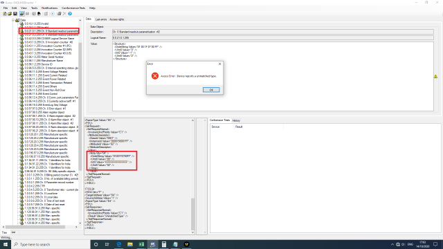

Hi sir,
i am facing some issue in IC 1 which is Data Ic and the object is Auto mode LCD parameter. its obis code is (0.0.21.0.1.255). the type is structure actually. but when we write any data it is showing error of unmatched type. here i am attaching screen shot for better understanding. please help me to solve this error.

Please, don't add pics. They are compressed and It's hard to read the data.
It seems that your meter is returning an array where are four different items. That is wrong. Your meter should return a structure where are four items or an array of structures.

when I first download objects I am having data shown like this :
<Structure>
<OctetString Value=""/>
<UInt Value=""/>
</Structure>
and this is ok. I also checked in the XML log file, it is taking data in structure form. my data is in structure form only, not an array of structures. so when I read this object the type is proper,but when I write something in this structure type it is showing a data type mismatch error. In the XML log file I have seen the type Array when I write something.
5 years 7 months ago
It's hard to read the pic, but for me, it seems that there is <Array> tag and not <Structure>. Can you check that?
husainmalkani@…
yes, you are right. the
yes, you are right. the request is like:
<Array Qty ="04">
<Octet string value =""/>
<Uint8 Value=""/>
<Int8 Value=""/>
<Uint8 Value=""/>
</Array>
This is the Log for writing the Data. and when i Read the data the response is like:
<Structure>
<Uint8 Value=""/>
<Int8 Value=""/>
<Uint8 Value=""/>
</Structure>

This is the Log file that I tried the values as you say. since I am getting the same error.
What is data on the value Window? I can't read it from the pic.
husainmalkani@…
In value window, the data is
In value window, the data is like:
<Structure>
<Octet string value ="01 00 1F 07 00 FF"/>
<Uint8 Value="0"/>
<Int8 Value="-1"/>
<Uint8 Value="2"/>
</Structure>
Now I know the reason. Your meter is using logical name 0.0.21.0.1.255, Standard readout parameterization. The data type is defined as an array in DLMS specification. Ask the meter manufacturer to change the logical name to something else or change the value to structure array.
