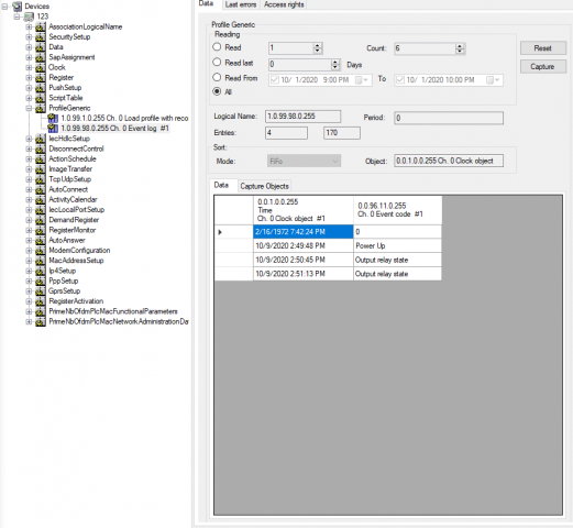

We are facing an issue concerning the profile generic.
In fact, when we start the meter for the first time and create the file corresponding for each profile generic, a random value is saved even before capturing the first element. (check the picture)
We think that error is leading to a second issue: when reading all the data of a profile generic the row are incremented of 1 due to the first random row so we are missing to see the last row.
Example of the picture:
In real we have 4 entries in use:
10/9/2020 2:49:48 pm -> power up
10/9/2020 2:50:45 pm -> output relay state
10/9/2020 2:51:13 pm -> output relay state
10/9/2020 3:01:07 pm -> power up
but when reading (you can check the picture) this is what is shown:
8/29/1972 1:.6:56 am -> 0
In fact to be able to see this event "10/9/2020 3:01:07 pm -> power up" we have to wait that another event happens. So instead of seeing the information about the new event we will see this one "10/9/2020 3:01:07 pm -> power up". We are delayed of one row all the time.

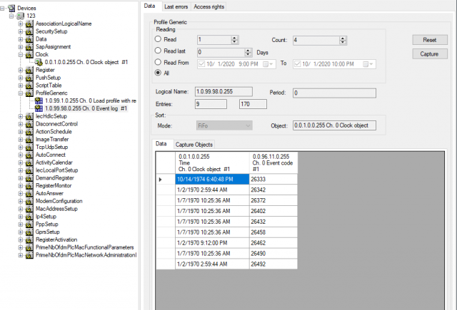

Can you please explain to us what do you mean by that : "Profile generic entries in use and Profile entries are not serialized." ? and what the number 0x60 means in : "IGNORE_ATTRIBUTE(BASE(loadProfile), 0x60)"?
We noticed that you create a function named getProfileGenericBufferEntriesInUse(gxProfileGeneric* pg) but you didn't use it, is it intended or not?

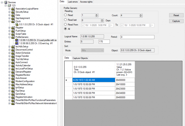

The issue is not solved, all the reading data are now wrong and illogic. (check the picture)

Picture of the load profile
Picture of the load profile showing the error described above.
5 years 11 months ago
IGNORE_ATTRIBUTE was not planned to add to this release and it's still on testing. Using IGNORE_ATTRIBUTE you can skip values that you don't want to save to the EEPROM. Example register value.
getProfileGenericBufferEntriesInUse is used in in next release. It's not used at the moment.
Can you try to remove the rows file and check is this still happening?

What do you mean by remove the rows file?
If you meant to reset the profile generic then capture new values, we try it and the error is still happening. All the values and date/time are wrong and illogic.

By removing the rows file I mean to reset the capture file. For some reason, ServerExample2 was not updated to GitHub from our internal repo. It's not updated and the profile generic is working. I'm sorry about this hassle.
