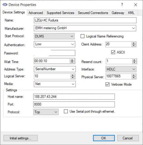

I have a EMH LZQJ-XC in combination with the EMH Variomod-XC LTE. I can connect to the meter with their software (Combimaster), but not with Gurux DLMS Director. All setting are OK. Beneath the log if I connect:

What could cause the problem?

Change the Logical server from 10 to 0. Is 10077865 serial number of the meter?

EMH came with the following
EMH came with the following solution: Unselect Create 7E1 parity. I can now connect to the meter and all parameters. Thank you.
Solved.
6 years ago
So you are not using direct TCP/IP connection to the meter. You have Moxa, etc in the middle.
I'm glad that this is solved. Serial port settings might sometimes cause a lot of pain.
