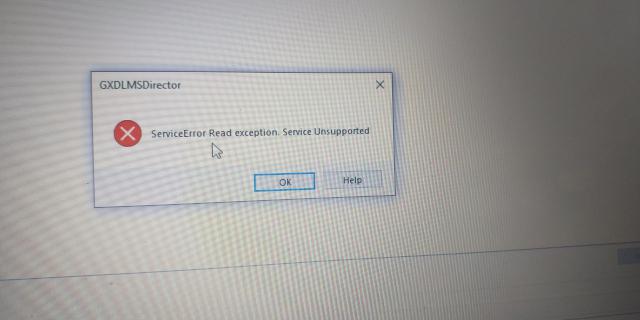

Please let me know how to
Please let me know how to solve this matter ( in picture attach )
Thank you

In reply to Please let me know how to by BuiLy
Hi BuiLy,
Hi BuiLy,
Please, create a new topic if you have a new question. I'll answer your question there.
