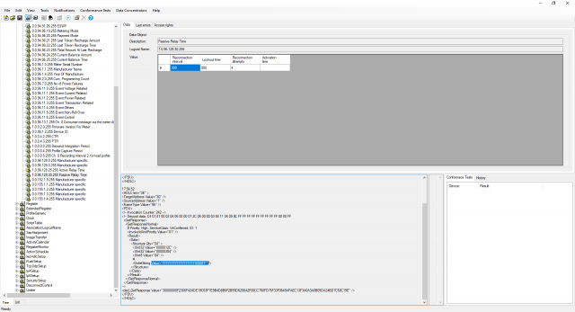

I am trying to write Passive Relay Time (1.0.96.128.30.255) into IS15959-2 meter.
In that, If I change any value of structure and try to write, I got an error message as shown in the attached image. Please check.
Following is the response from meter:
<Structure>
<UInt32 Value="500" />
<UInt32 Value="900" />
<UInt8 Value="4" />
<OctetString Value="FF FF FF FF FF FF FF FF FF FF FF FF" />
</Structure>

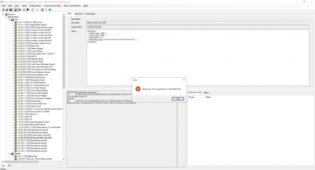

And the error message in the screenshot was "String was not recognized as a valid DateTime."
5 years 11 months ago
I believe that you have changed UIType to DateTime. Select "Passive Relay Time" object. Then select "Access rights" tab and check Type and UIType for attribute #2.
Check that Type is structure and UIType is None. If Type is something else, read the association view again. If UIType is something else, you can just change it.

Yup, The data type for attribute #2 was DateTime. After updating UIType to None it is working properly.
Thanks for the quick update.

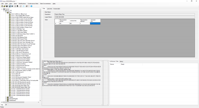

You should see UI like in the picture.

I have checked with the latest Director.
For Passive Relay Time, It has ReadWrite access and from Director not able to write.

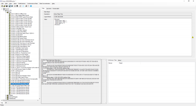

For Active Relay Time, it has Read-only access and from Director, it gives a writeable textbox.
Please check the attached images for both obis codes respectively.
Bhaumik
5 years 10 months ago
Please find Active Relay Time
Please find Active Relay Time image
You need to change the value if you want to write it. You didn't talk from Active Relay Time and it's not added. We'll add it later.
Select "Access rights" tab and check access level for Active Relay Time image. I believe it's ReadWrite and not Read.

Yes, I haven't informed regarding Active Relay Time as it is read only access.
And In Passive Relay Time, We are trying to change the value in grid but it is not updating.
Please check for Passive Relay Time write operation once
After you have set new values you need to press "Write" -button to write value to the meter.
Write button is gray until you have change the value.
In your previous post you wrote: For Active Relay Time, it has Read-only access and from Director, it gives a writeable textbox.
Textbox is writable because the meter returns the ReadWrite access level or you have changed it from the "Access rights" tab. Check that.

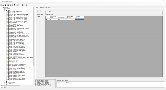

In the latest Director, When I am read Passive Realy Time, the DateTime value not shown.
Please check this in the attached image.
The reason is the date-time value (FF FF FF FF FF FF FF FF FF FF FF FF). This means that the date-time value is not used. Try to write a new date-time to the meter and read it again.

As per the screen shot, you can see that I received proper data for date time. However, can not write it properly.
Thanks.
Please, don't use images. They are compressed and I can't read them. As far as I can see from the pic, year, month, day, hour, and minute are not used.

You need to give a new date-time value in your localization format. Like in the picture below. When you double click the cell you can change the value.
