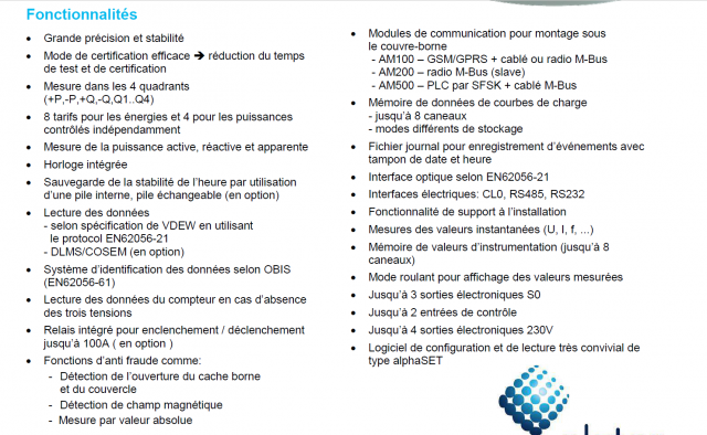

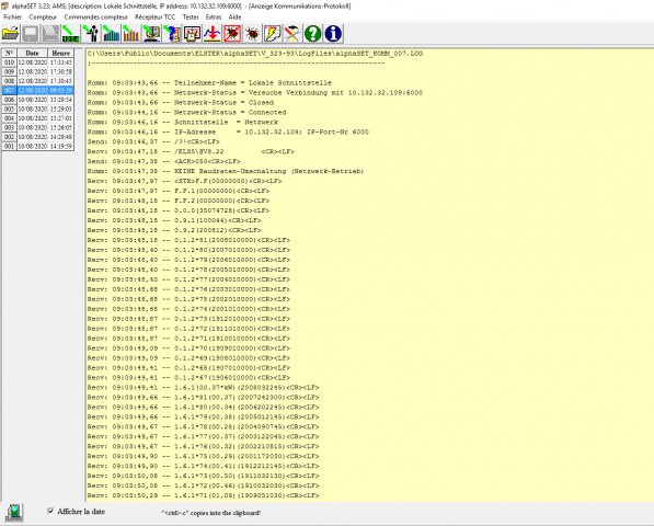

By mohamadop , 12 August, 2020 Forums DLMSDirector Hi Mikko , Can i read this meter with GXDLMSDirecto , You can find the attached datasheet . Image Hi, Hi, DLMS/COSEM is available in option. If your meter is supporting DLMS, you can read it using GXDLMSDirector. BR, Mikko Dlms /cosem is available in Dlms /cosem is available in option , does mean it supports dlms ? Hi, Hi, It means that you need to buy special version from the meter that supports DLMS. The normal meter doesn't support DLMS/COSEM. BR, Mikko Ah okey , So with this one , Ah okey , So with this one , we can't read it with GXDLMSDirector ? Thanks Mikko for your reactions . Hi, Hi, I don't know what version you have. You need to ask this from the meter vendor is DLMS supported or not. BR, Mikko I can read it with alphaset I can read it with alphaset software , You can see the log file , they communicate with which protocol ? Image Hi, Hi, Your application is using IEC 62056-21. https://www.gurux.fi/DLMSCOSEMFAQ I can't tell is your meter supporting DLMS or not. BR, Mikko
