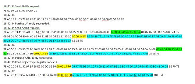

Below is DLMS Director log
Yellow- Frame Counter
Green- System Title
Blue- Ciphered PDU (Ciphered Data+ Authentication Tag)
Initialization vector-Using frame counter(Yellow marked)and System title(Green marked)
Authentication key+Encryption key as provided by manufacturer, We can generate the Ciphered PDU
And is matched with Gurux Director ciphered AARQ (Blue marked)
But use same technique my read request ciphered not matched with DLMS director log.
I used gurux dlms director log framecounter(yellow marked)+system title(green marked) alongwith encryption key and authentication key not able to generate ciphered data. Is any other technique for this ciphering ?
Is frame counter show in read request as yellow marked used for Ciphering?

As you require,Please find the raw data which is same as image attached marked with colour for differentiation.
